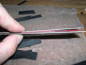

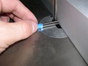

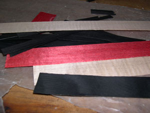

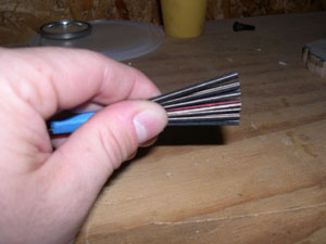

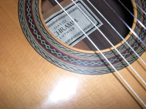

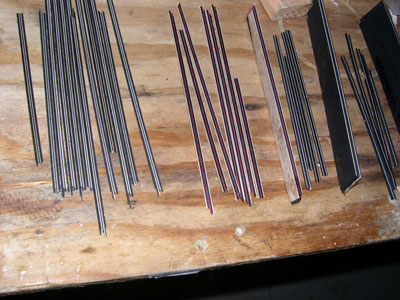

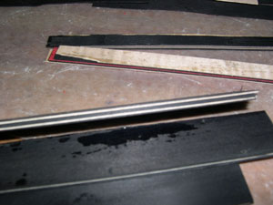

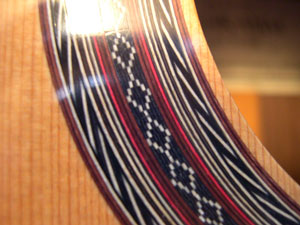

Here are a few pics of my process for making rosette tiles. The pics here are a close replica to the tiles on my Schramm guitar which has a copy of the 1937 Hauser rosette. Sorry if these pics take awhile to load. Lance--feel free to delete if this is hogging up too much bandwidth.
veneer strips thicknessed to .025"
veneer strips glued together to form logs
finished logs
.025" strips cut off the sides of the logs
cut strips from the glued log

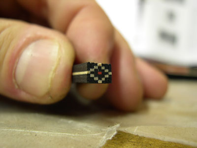

cut strips glued together to form final log
final log will have an end-grain with the mosaic tile design
2mm tiles are cut from the final log
tiles will be inlayed in rosette like this
closeup of Hauser rosette

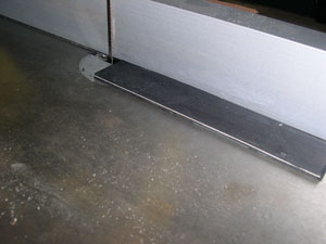

On the final construction picture, where you are slicing off the tile, I'm not clear on how you keep those little guys from falling down the "throat" on your bandsaw when they slice off. Or do you just pick them up at the bottom of the saw?
Nice looking work by the way!
PostPosted: Thu Jun 16, 2005 2:45 pm
Posts: 993
You guessed it, right now I'm digging the tiles out from falling through the saw. The ideal way would be to get a very thin kerf blade for my table saw, and then construct a table-saw throat plate, so only a small portion of the blade is exposed. Once I get settled out in Indiana, that will be added to my list of projects for sure.

Would it be possible to build some sort of jig for slicing the tiles without losing them, something of a zero clearance throat for the bandsaw with a built in fence like so?
Or would that be a really bad idea given the nature the thin blade involved with a bandsaw? Maybe have the fence stop right after the blade so that each successive cut pushes the peice before it to safety, or cut a hole in it and hook up a dirt devil to scoop away the peices before they fall in

Grab some scrap from a headplate, put it up against the fence, and saw half way through it. Then saw your tiles on top of that since the hole is now gone, and you won't have to dig them out of the bandsaw.

i haven't made a rosette in a long time but i think it should be mentioned that after the first step of   artistially rendering your rosette to eatablish the general appearance, the next is to draw your tile pattern in colour. graph paper is the preferred drawing surface. i/4" grid works well to rough it, but metric 1mm grid is better for final sizing and layout drawing.
one used to be able to buy veneer sticks in a huge array of colours for laying up the logs if you did not feel like slicing up veneer.crazymanmichael38521.6764583333
PostPosted: Sat Jun 18, 2005 7:10 am
You can still get the sticks, from LMI for one.
PostPosted: Sat Jun 18, 2005 3:07 pm
Posts: 993
What's the easiest way to glue the veneer sticks? I wouldn't guess you'd use epoxy like the veneers. Do you just wick CA into the sticks? The sticks would be nice, but they sure cost a lot more. For an 8x8 tile, that would be 64 sticks which would be approx. $35.00 per rosette, not including all the other veneer rope and purfling required. I'd say the veneers are less than $2.00 per rosette, but the labor cost is much higher!
